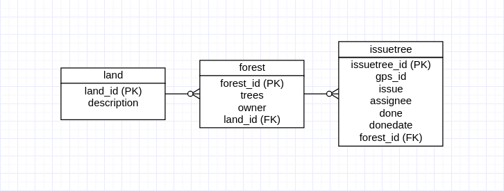

CREATE TABLE live.issuetree (
  issuetree_id integer UNIQUE NOT NULL,
  gps_id text NOT NULL,
  issue text,
  assignee text,
  done boolean,
  donedate date,
  forest_id NOT NULL,
  CONSTRAINT issuetree_pkey PRIMARY KEY (issuetree_id),
  CONSTRAINT forest_fkey FOREIGN KEY (forest_id) REFERENCES live.forest;

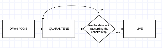

Using of a “data quarantine”
Let’s imagine that the tree-inspector collected all day data in QField. Standing in the middle of the mentioned stinging nettle and rabbit holes, running from wolves etc… Of course he made some mistakes while collecting data. In the evening he returns tired to the office, already thinking about the dinner meal his wife is cooking (or his husband, of course), and wants to upload the data from the QField project to the database. And what happens? Lot’s of error messages. He thinks about to solve them tomorrow, because his wife (or his husband) can get quite angry when he is late for dinner. But if he does it tomorrow, the data are only stored on the device and nowhere else overnight. He need to have them in the database. No matter, if correct or not. And this leads to the idea of the “data quarantine”.
Use Case
All data entered to the database (valid or not) need to be stored. The entries accepted from the so called live tables with all constraints, are stored normally. The entries failed because of the constraint, are stored in another table. In the so called quarantine table. So you have for every live table another quarantine table. This means, we need another table structure existing parallel to the live tables. We do it in two schemas: The live schema and the quarantine schema. So the tree-inspector synchronizes his QField without any problem to the database. The correct entries are written into the live tables. The incorrect into the quarantine. Actually all the data are coming into the quarantine and there is a Trigger passing them through to the live table. If they success, they will be stored in live and removed from quarantine. Otherwise they keeps staying in the quarantine. Same situation when the quarantine-clerk later corrects the data entries in the quarantine. On an update they are pushed into the live-table. If success, all good. Otherwise the entry keeps staying in the quarantine.
Structure
And how we do that?
It’s all solved by using triggers. SQL triggers are procedural code that are automatically executed on an action on a table or view. For this solution we actually need two trigger per quarantine table. After insert into or update quarantine table, a trigger should be fired for every entry, doing this: Insert the same entry into the live table. If success, then delete the entry in the quarantine table. Else write the info to the current entry in the quarantine table. Probably you noticed the problem with the recursion, but let’s not think about it at the moment :-)

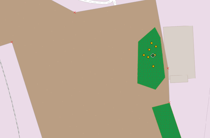

And it looks like this
The yellow points are the issue trees in the live. If we create another one and have a mistake in it (GPS Id wrong), then it’s stored in the quarantine (pink). When we correct the data it’s written over the quarantine trigger into live. If succeeded, the point changes the color to yellow. Actually the yellow point appears (live) and the pink point(quarantine) disappears, because the entry is inserted into live and deleted in quarantine.

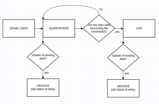

Third schema “archive”
So we created a third schema parallel to live and quarantine. The archive schema. This means every table in live does not only have a quarantine table accordingly, but also an archive table too where all the old status of entries including the timestamp, when it has been archived. Of course not only the changed live data are stored in the archive, but also every changed data from quarantine.
Use Case 1
The tree-inspector enters an entry of an issue tree that already existed in the live table to the quarantine (1). The after insert trigger is fired and it tries to write to the live table. And with success. The entry is written to the live table (2). This means, before the entry in live is updated, the old one was copied to the archive table (3). Then in the same transaction the entry in the quarantine is deleted (1). Means the old status is copied to the archive too (4). So there will be the updated entry in the live-table (2), no entry in the quarantine-table (1) and two entries (3 and 4) in the archive table.
Use Case 2
The tree-inspector enters an entry of an issue tree that already existed in the live table to the quarantine (1). The after insert trigger is fired and it tries to write to the live table. And it fails. The entry in the quarantine will be updated with the error-message (2). The old status is copied to archive (1). The office clerk makes no the changes to this entries. The trigger is fired and this time it could write into the live-table with success (3). So the old entry is copied to the archive (4) and after deleting the entry in the quarantine, there will be the second old status of quarantine (5) in archive too. So there will be the updated entry in the live-table (3), no entry in the quarantine-table (1 and 2) and three entries (1, 4 and 5) in the archive table.
Structure
And how we do that?
It’s solved by using triggers too. We actually need only one trigger per table, but not only in quarantine, but also in live. It has to be fired before every update of every entry, doing this: Insert a copy of the current entry into the archive table with the status it had until the update we are doing right now.
