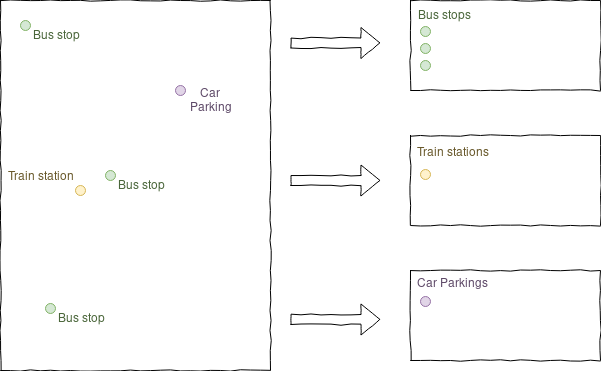

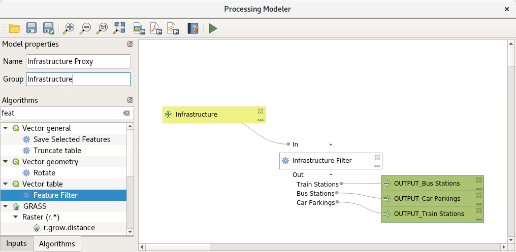

Now back to the job of splitting the infrastructure layer into 3 different layers. To do this job visually and easily within QGIS, there is now a new algorithm available in QGIS 3.2. It is called Feature Filter and available in the processing modeler. To make use of it, we open the processing modeler and first add a new Vector Features input and name it Infrastructure. Since we know in this project we will always deal with points, we can make already specify that in this first dialog.

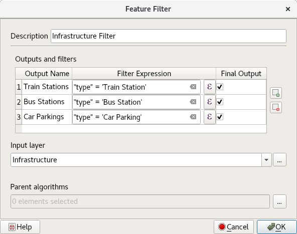

Let’s now add a Feature Filter algorithm and use the following configuration: The Infrastructure layer is set as input, and we define three outputs for Train Stations, Bus Stations and Car Parking. All layers will be final outputs on which no further transformations will be applied within this model and they will be directly written to a new layer.
Now it’s time to run our new model and check that it does what it promised. We can also uncheck the final output checkbox and send filtered features to further processing algorithms. For example sending them through a buffer based on an attribute size (although as a QGIS professional you know you should rather be using styles than modifying the geometry in most situations in such cases).
