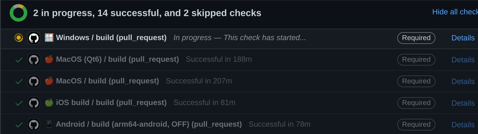

So the last few weeks and months we have been working closely with upstream to bring building for Android and iOS up to the same level as desktop platforms. The relevant parts are now in a clean state.

  • • We can upgrade a dependency in an isolated branch and only release it when it works on all platforms
  • • We can optimize the code for a given set of dependency versions and if a bug is fixed in a certain dependency version, we are sure we can ship this fix on all platforms promptly
  • • We maintain the QField source code as well as dependency versions in a single repository, what makes development more streamlined
