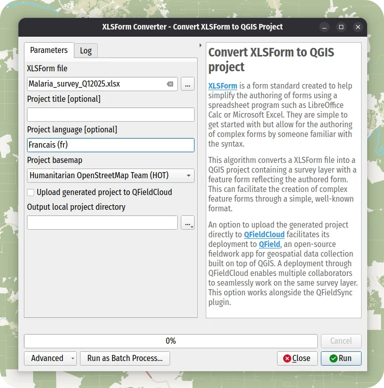

The plugin adds an algorithm to QGIS’ processing toolbox that converts a XLSForm file – Microsoft Excel’s .xls or .xlsx as well as LibreOffice Calc’s .ods – into a QGIS project containing a main survey layer and a basemap.
The layer’s geometry type will reflect the first geometry-driven question type found in the XLSForm, namely a point geometry for geopoint, a line geometry for geotrace, or a polygon geometry for geoshape.

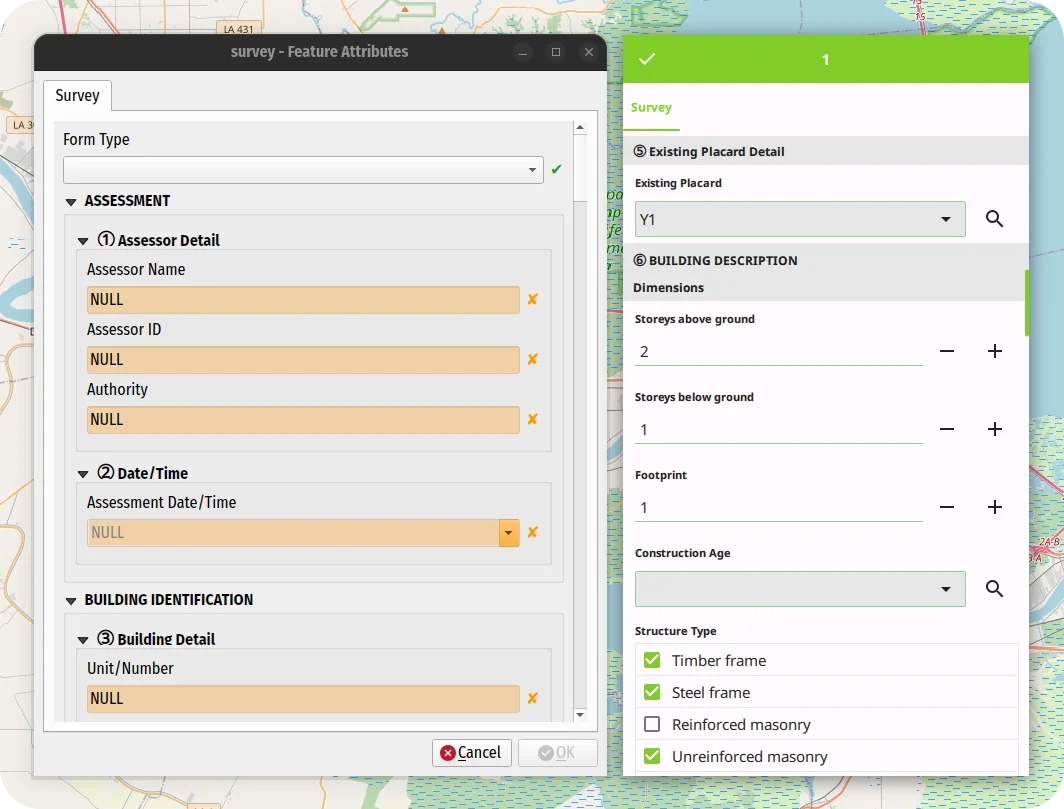

For XLSForm repeat blocks, the algorithm generates additional layers and configures parent-child relationships to bind them to the main survey layer. These layers are hidden from the layer tree by default, keeping the project simple and user-friendly—even for users unfamiliar with QGIS.
For questions that capture media content—such as photographs, videos, and audio clips—the converter sets up the project so users can easily record them in QField with a single tap.
Pro tip: Since the converter is an algorithm, you can use it to build complex, model-driven survey projects via the QGIS Processing Modeler. You can also run conversions in headless environments using qgis_process. The possibilities are endless!
