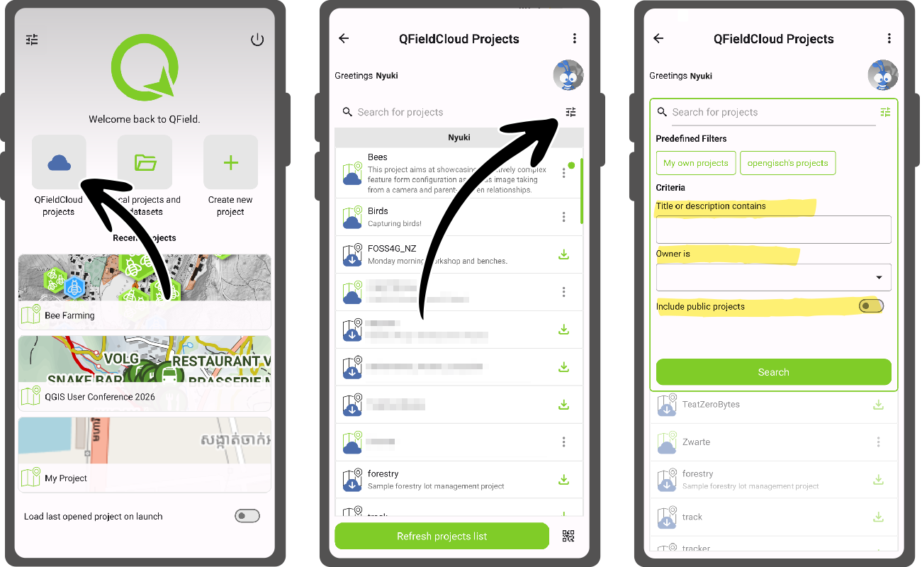

Upload your mapping projects onto QFieldCloud and make them public through the web interface or QFieldSync. The public can then hop onto QField, log into QFieldCloud, and get to the maps by searching for the user and project names.

Note that since QField 4.2, improvements made to the experience around cloud projects filtering have made finding these public projects much simpler.

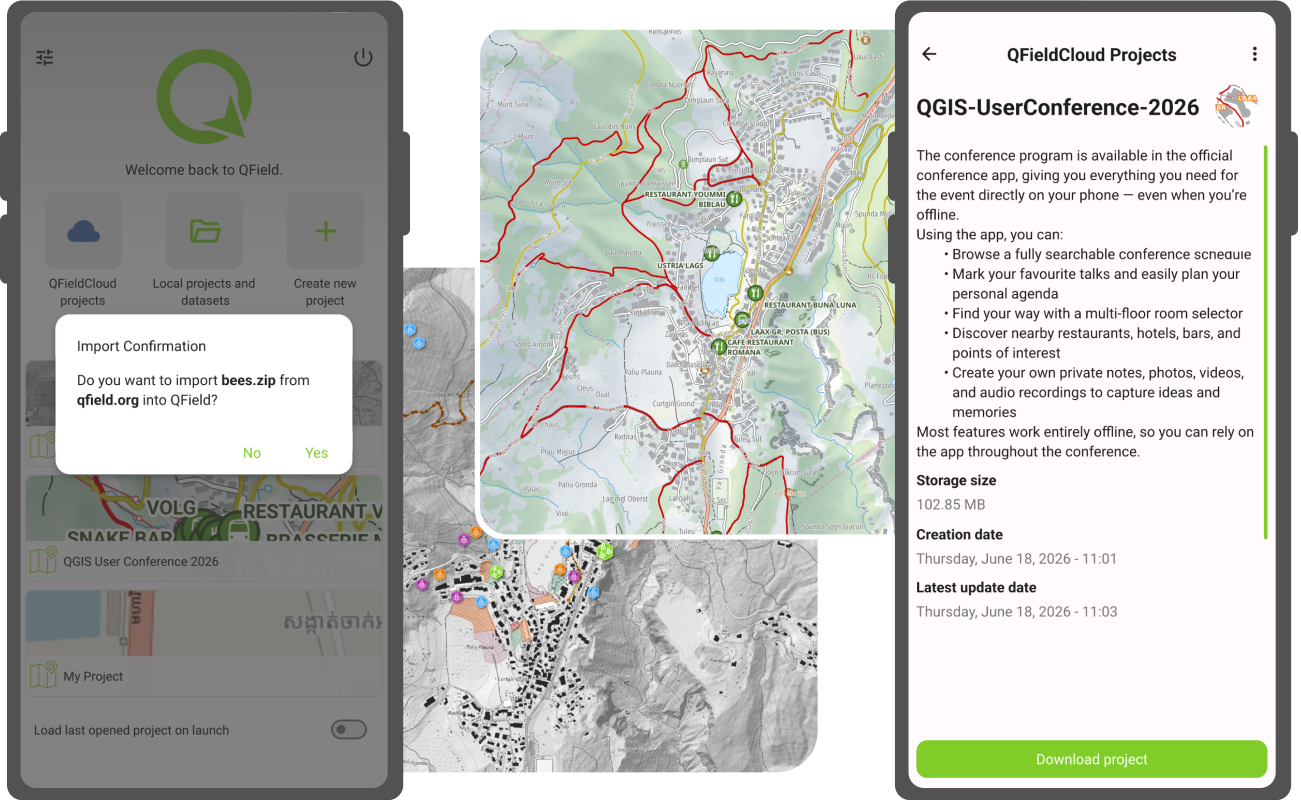

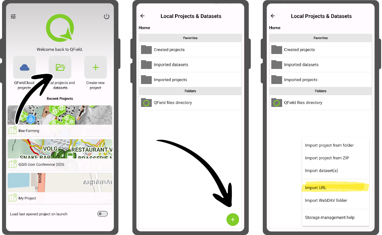

Sharing maps can be done by compressing a QGIS project into a ZIP archive or simply sharing a georeferenced PDF and make that file available through a web site URL. Users wanting to import these files into QField then open the local projects and datasets panel from the welcome screen, click on the bottom right plus sign ‘import’ button, and select the ‘Import from URL’ menu action.
Importing from a URL works across all platforms QField runs on: Android, iOS, Windows, and Linux.

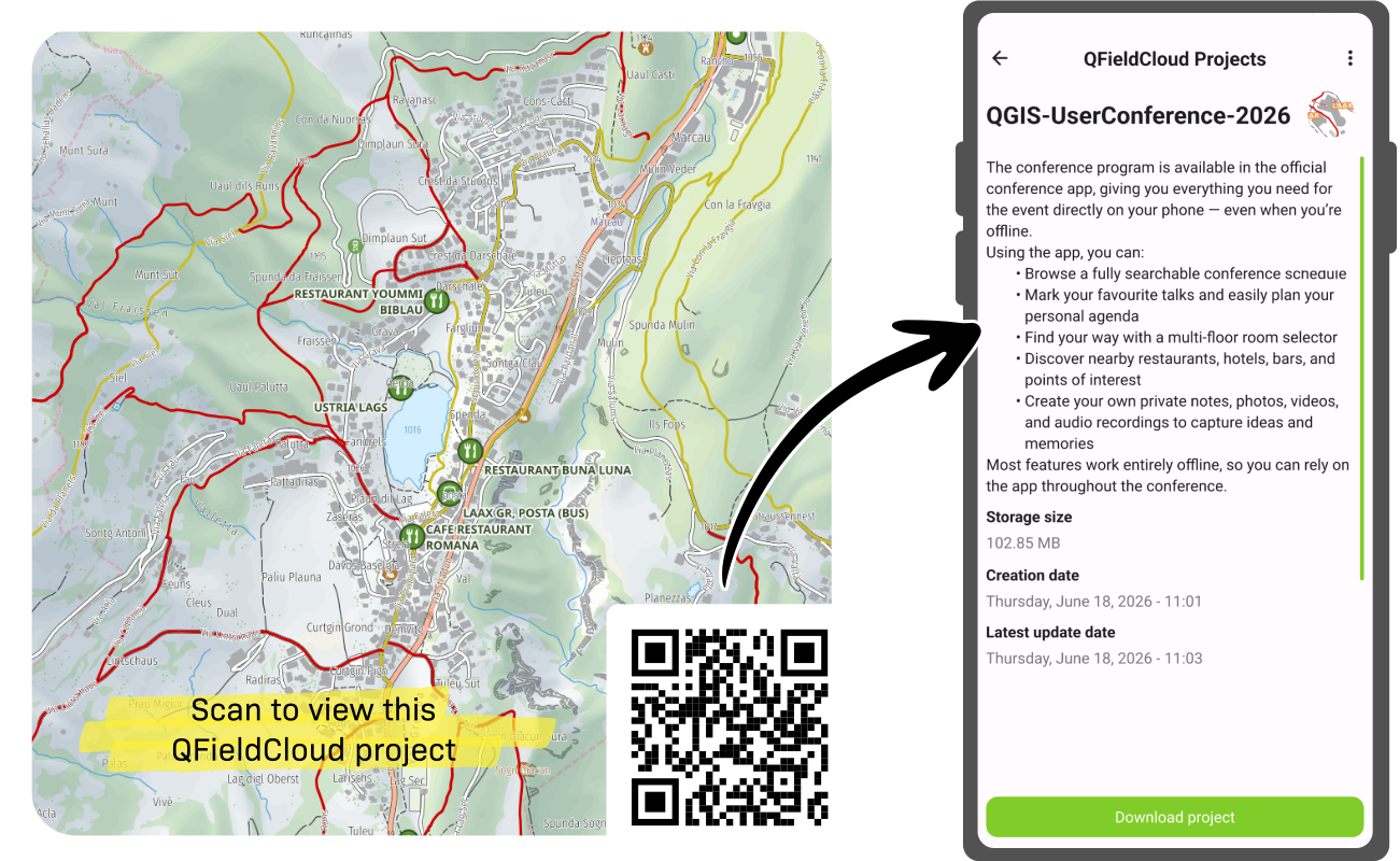

For maps shared on QFieldCloud, users can generate QR codes using their favorite online tool or application by using the following URI format:
qfield://cloud?project={username}/{project_name}
Simply replace the {username} and {project_name} with the username or organization owning the project as well as the project name. The resulting QR code can be scanned from devices using the operating system camera and will automatically open QField to an informative cloud project details view.

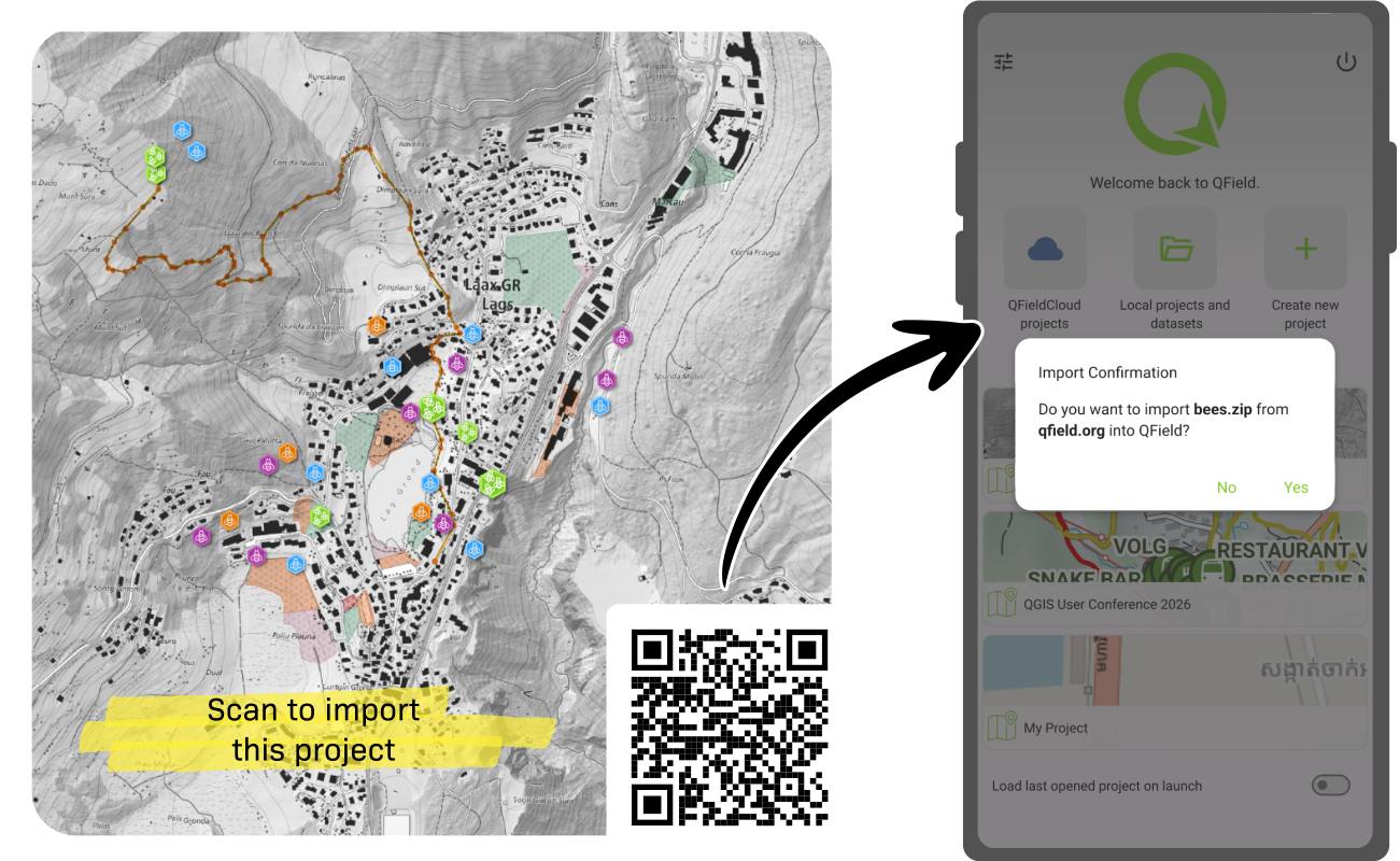

For maps shared through a web site URL, similar QR codes can be generated by using the following URI format:
qfield://local?import={url}
Simply replace the {url} with a web URL that points to a compressed QGIS project ZIP or georeferenced PDF file (e.g. http://qfield.org/sample-projects/bees.zip) . When scanning these QR codes, QField will open a dialog asking users whether to proceed forward with the importing of a file name (e.g. map.pdf) from the URL’s domain name.
