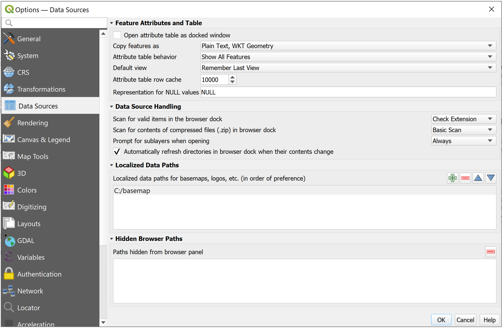

In QGIS, open Options > Data Sources > Localized Data Paths. In there, add the path to the external data.
