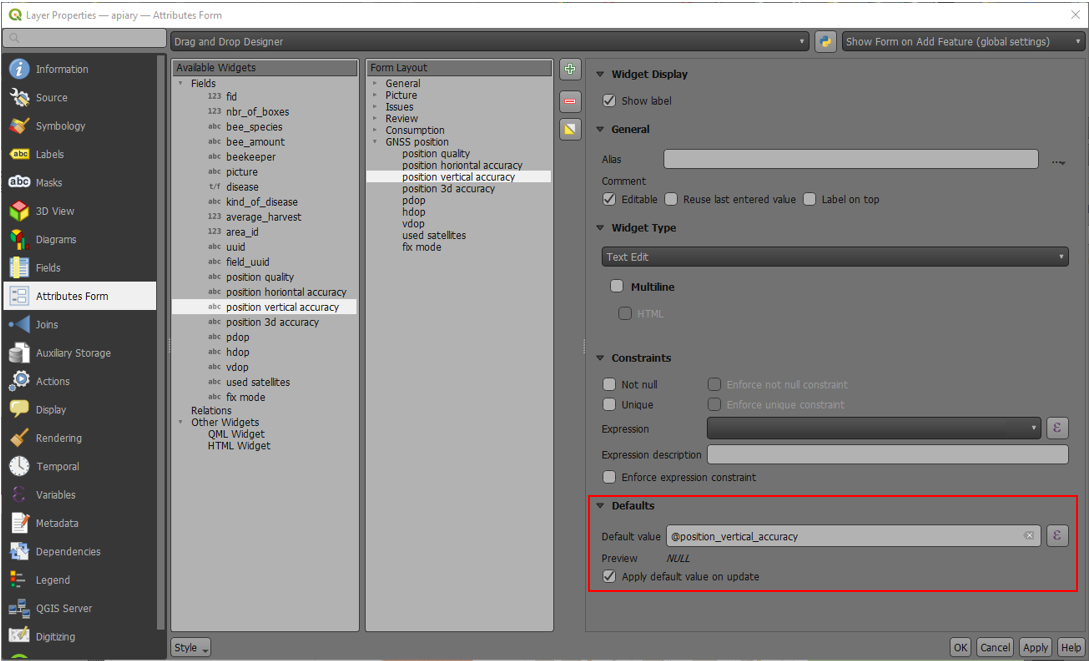

Additional variables
You can get access to positioning information through additional expression variables.
These will only be available when positioning is enabled.
These variables are commonly used as default values for fields to keep track of the quality of
individual measured points.

- @position_vertical_accuracy
- The vertical accuracy of the coordinate (in meters) as reported by the sensor. It is only available when the crosshair is snapped to the sensor.
- IE

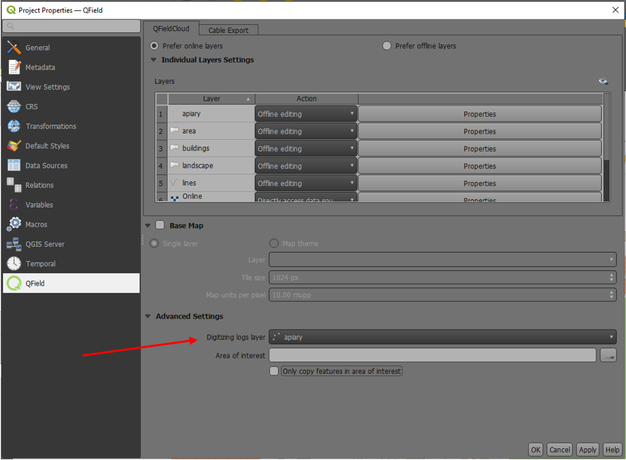

Vertex log
It is possible to setup a log layer of the collected vertices.
This allows to keep track of meta data for each vertex like GNSS quality attributes and more.
To set this up, a point layer can be added to the project and attributes configured to store this information.
Then the user assigns the role „digitizing logger“ on a point layer.
