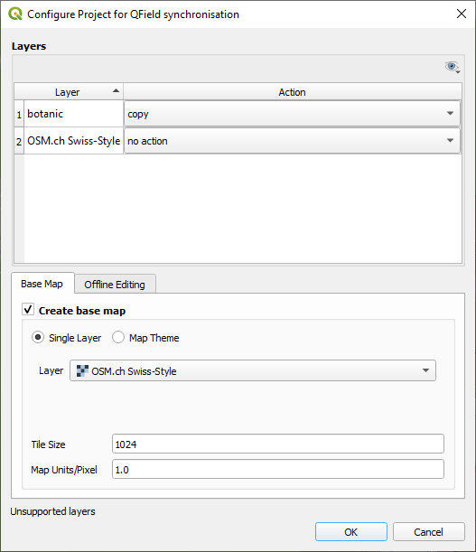

In QGIS with the plugin QFieldSync, set the base map to the „Project Configuration“
sync_basemap
Then make the package of the project to load it on your device.

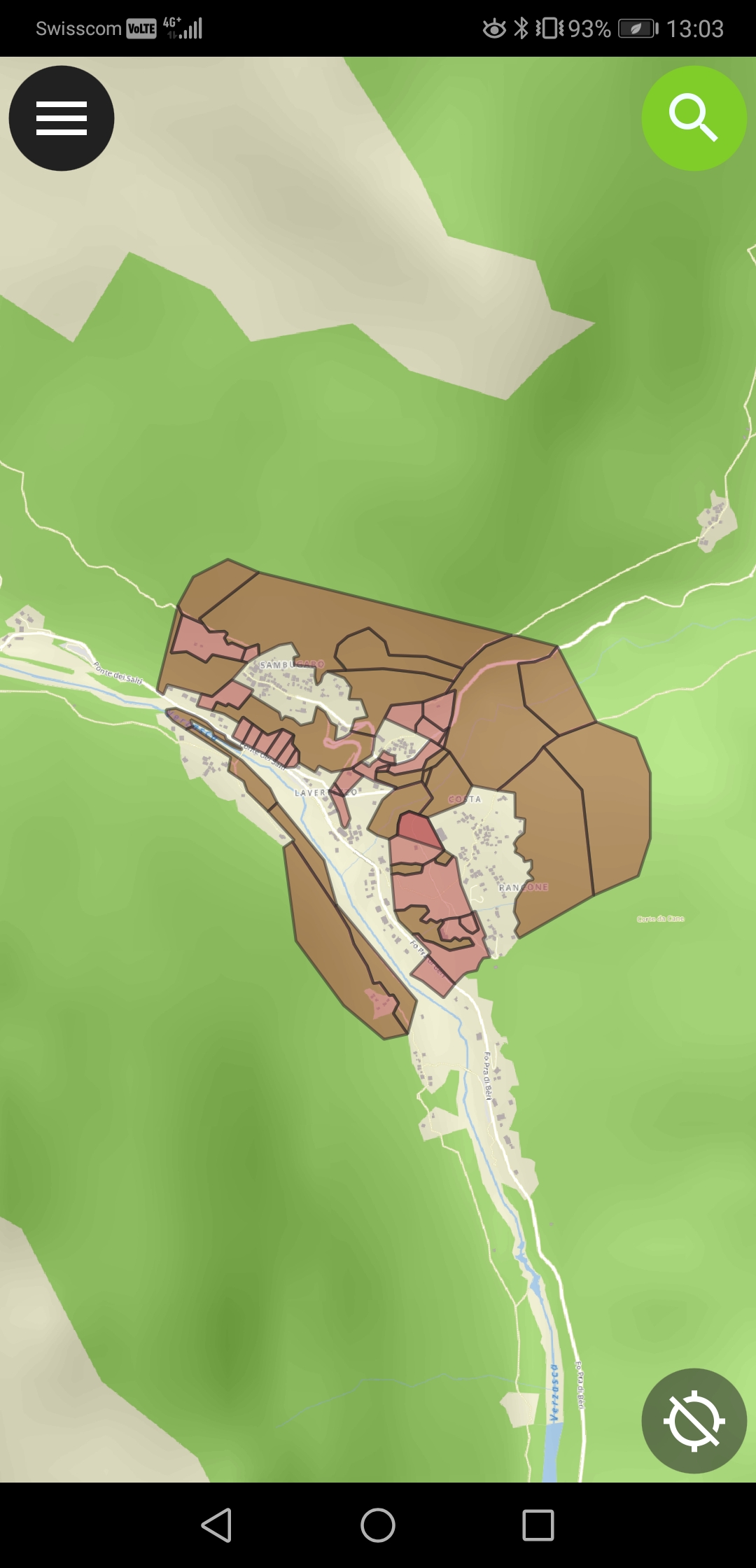

Below the result on QField.
