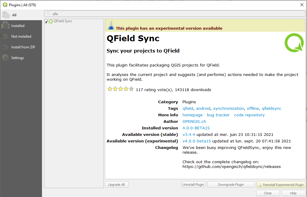

Installation
In QGIS, open the plugin library and search for qfield sync. Select the plugin in the list and click on Install.

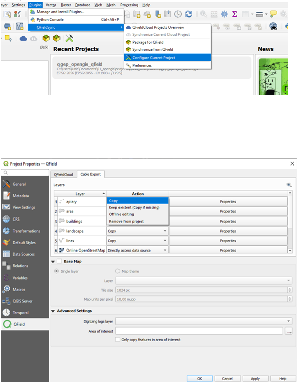

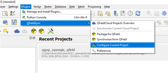

The project configuration is saved in the master .qgs project file. This way it is possible to pre-configure a project once and use it repeatedly.
../_images/qfield-sync_configmenu1.png

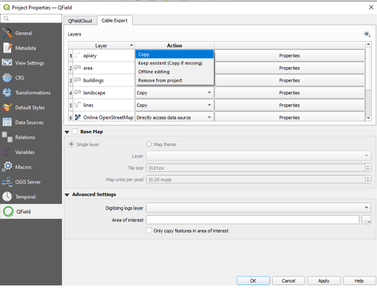

Layer configuration
../_images/qfield-sync_config1.png
In the project configuration dialog, an action can be defined for each layer individually. Depending on the layer type, different types of actions are available.
Copy
The layer will be copied to the package folder. This is only available for file-based layers.
No action
The layer source will be left untouched. This is only available for non-file-based layers like WMS, WFS, Postgis…
Offline editing
A working copy of the layer is copied into the package folder. Every change which is done in the packaged project during work is recorded in a changelog. When synchronizing the changes back later on, this log will be replayed and all changes also be applied to the main data base. There is no conflict handling in place.
Remove
The layer will be removed from the working copy. This is useful if a layer is used in the basemap and will not be available in the packaged project.

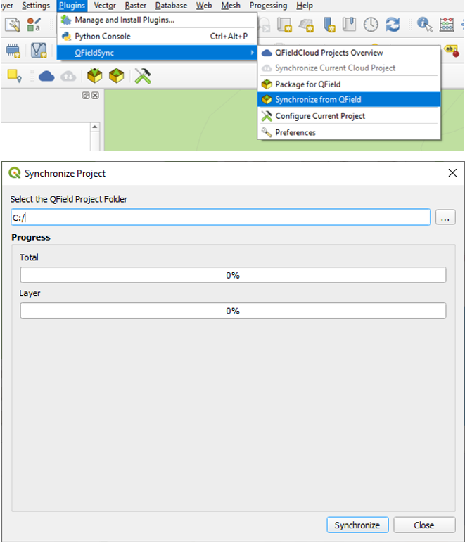

Synchronize from Qfield
When you want to synchronize what you have collected, re-open the project in QGIS (the one you saved with a regular Save As).
Copy the project folder from your device to your computer and use the Synchronize from Qfield menu to synchronize your changes from the protable project to the main project.
../_images/qfield-sync_sync1.png
Make sure that you synchronize your data back only once. That means, if you go out again to collect more data, you should create a new QField package before to avoid sync problems later on (like e.g. duplicates).
