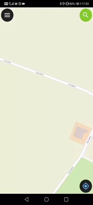

A short press on the GNSS button will turn on the GNSS and center to the current location once positioning information is available.
Activate edit mode and press on the target button, the cross in the center means it is using GNSS positioning.
gnss_use

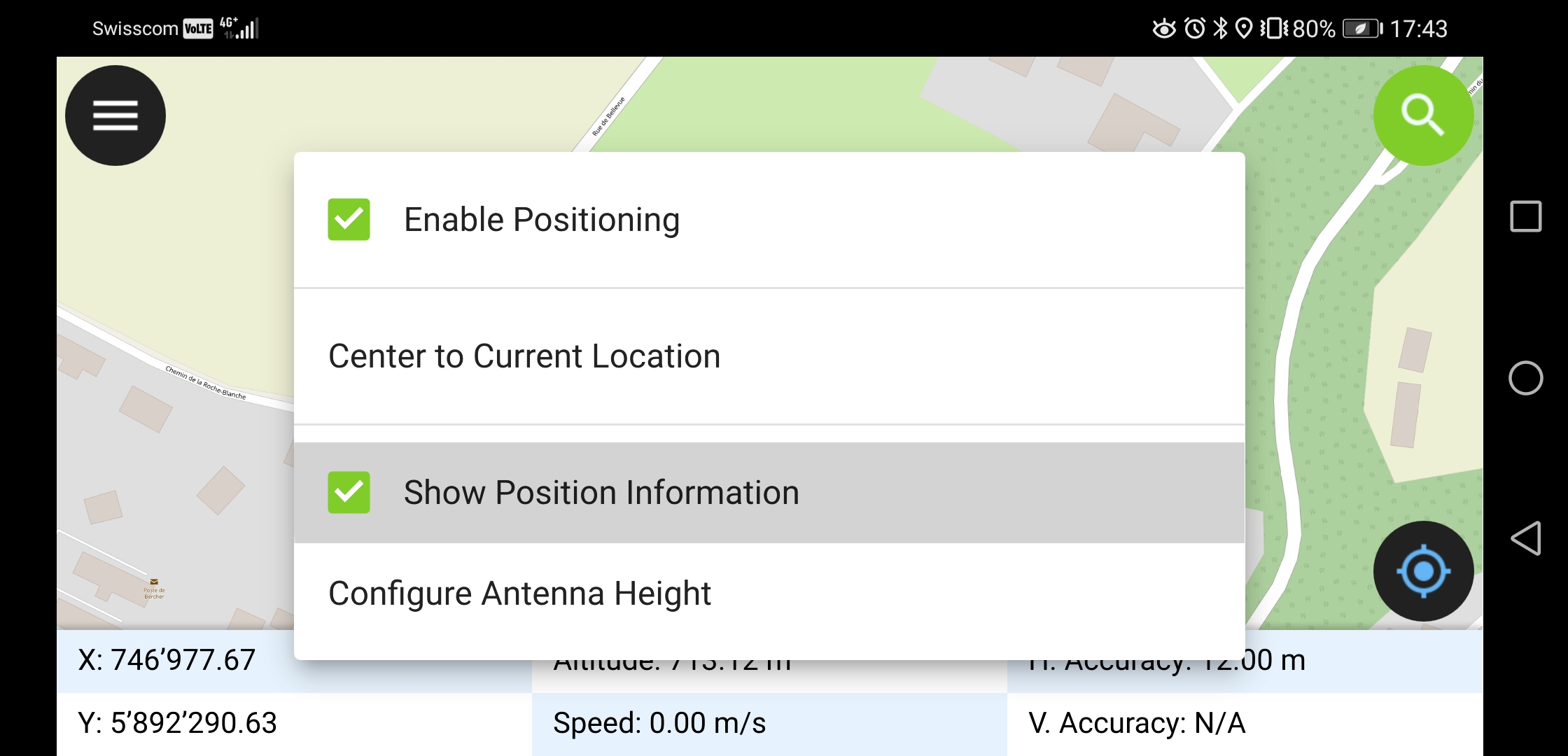

A long press on the GNSS button will show the positioning menu.
Inside the positioning menu you can turn on the positioning display which will show the current coordinates which are reprojected into the project CRS along with precision information.
user-guide_gps
If you see WGS 84 lat/lon information instead of information in your project CRS, you probably have no signal yet.
