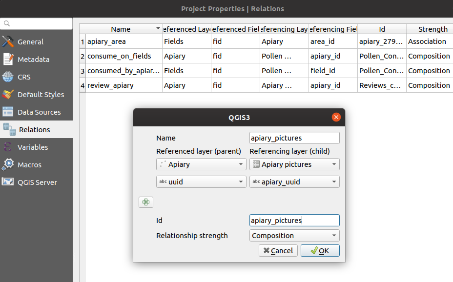

Relations
Create a relation with:
  • apiary Referenced layer
  • id Referenced field
  • apiary_picture Referencing layer
  • apiary_id Referencing field
  • strength Composition

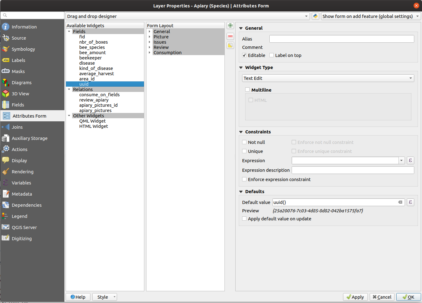

apiary
Set the default value of the field id to uuid(). No need to show it in the form.

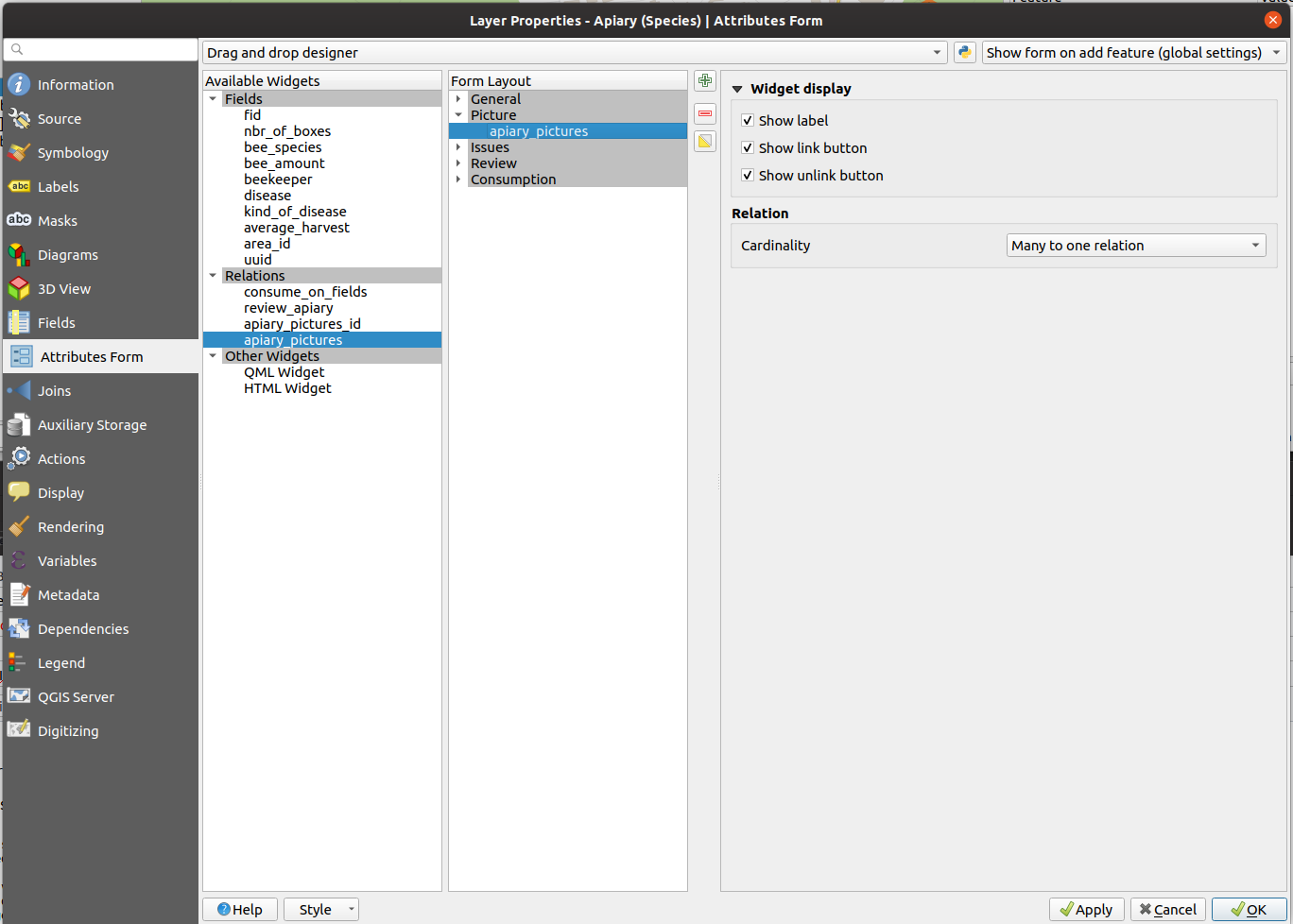

widgets
Set the relation widget to Many to one relation and add the relation to the form

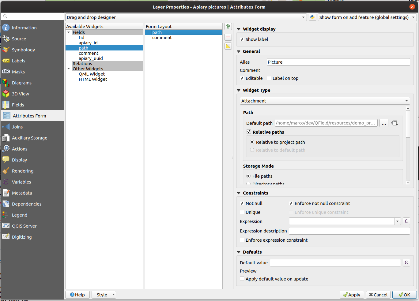

afbeelding
Set the widget type of the field path to attachment and add it to the form
