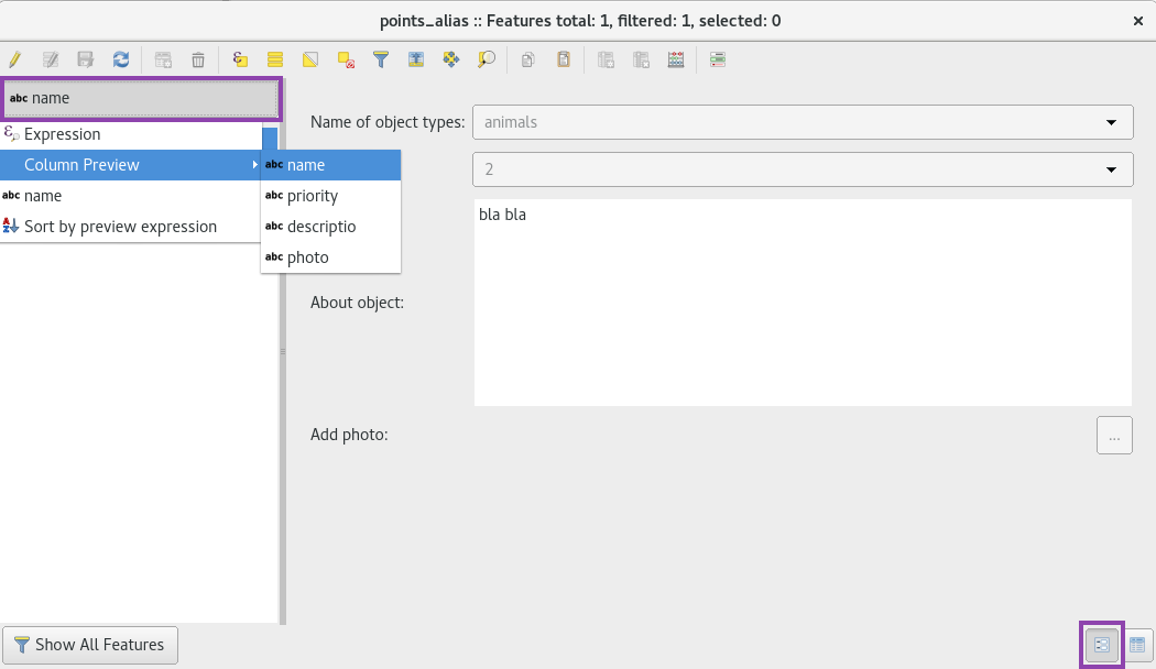

Display Expression
In QField, objects are identified with a name. The expression to generate this name can be defined by opening the attribute table in QGIS and switching to the form view. Choose the appropriate field or an expression in the list there. Starting from QGIS 3, this can be done directly from the Vector Layer Properties ‣ Display page.
The display expression is also used to search in layers.
Define display expression
The display expression will be used to represent features with an identification string throughout QField.

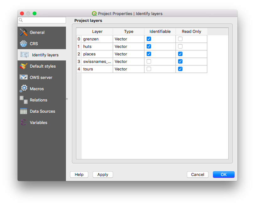

Read only, non-identifiable and searchable layers
Some layers in a project are just there for pure visual purpose. Such layers should not show up when a user taps somewhere to identify objects.
Some other layers serve as source of information and shouldn’t be modified by the user. It is possible to protect layers from editing attributes or adding and deleting features.
It is also possible to configure which layers are searchable.
To configure identify, readonly and searchable behavior, go to the Project ‣ Project Properties ‣ Identify Layers page and activate the checkboxes to match your desired behavior.
Configuration of layers that will not be identifiable, not modifiable and/or not searchable.
