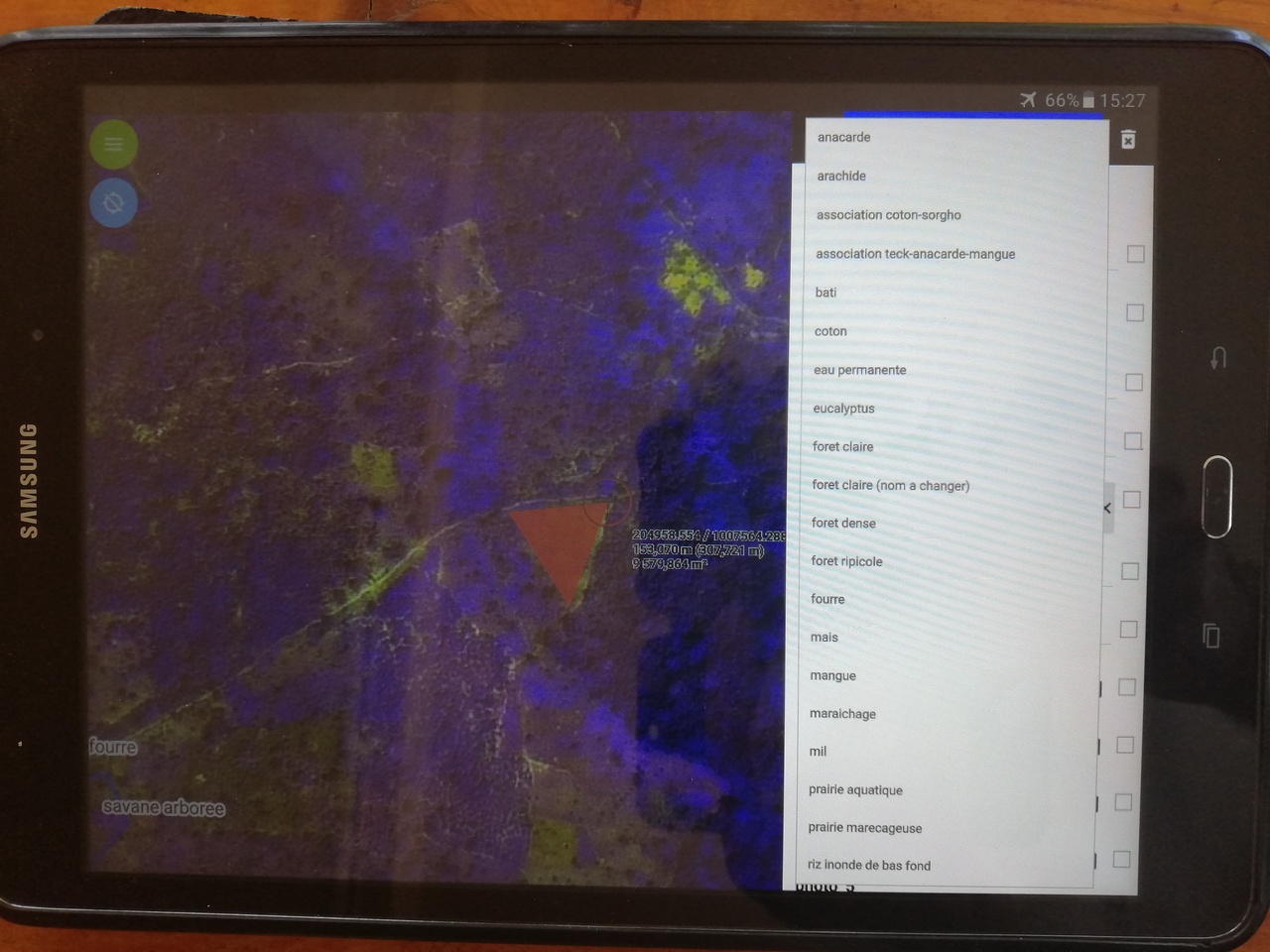

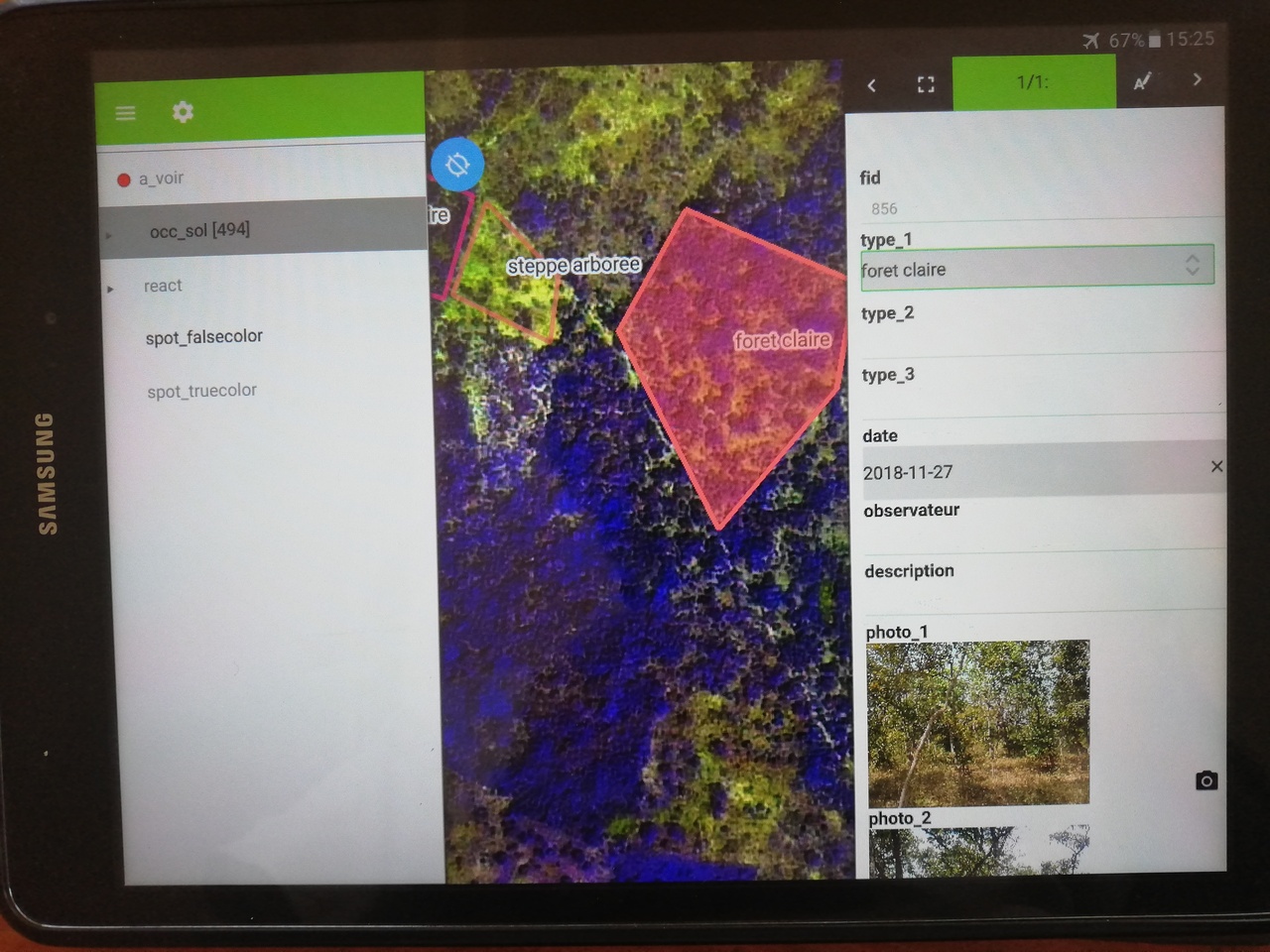

On the field, we were able to move around easily in motorbike without getting lost, thanks to our location displayed on QField with the satellite image as background. When a parcel of interest was identified, we were able to draw its perimeter in QField and very easily fill-in the proper information on the attribute table (land cover type, pictures). When hesitating on the land cover type to attribute to a given parcel, we were able, in “live” (i.e. on the ground), to quickly look at previously retrieved parcels and compare them to the parcel of interest (with the pictures and the satellite image).

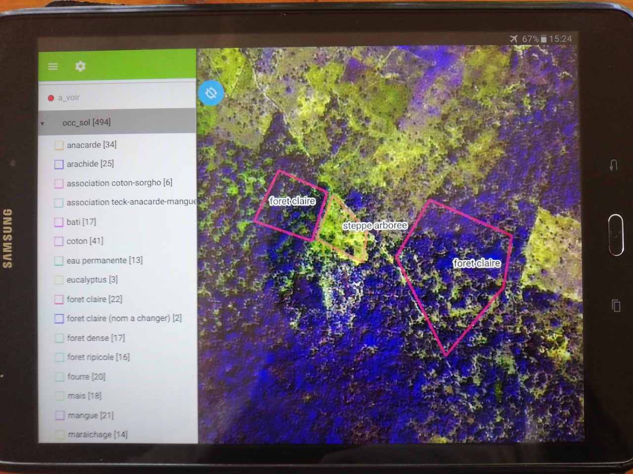

We were able, without any extra effort at the end each field working day, to see the progress of the work: which pieces of our study area we had covered, which remained to explore, how many parcels we had got for each land cover class and how many remained to retrieve. This is very appreciable in such conditions, where work can be testing and nights can be shorts. Back in office, we did not have to realize fastidious and time-consuming work such as digitalizing the parcels from a traditional GPS point layer, linking the pictures to our land cover layer, etc., which traditionally took days of work.
