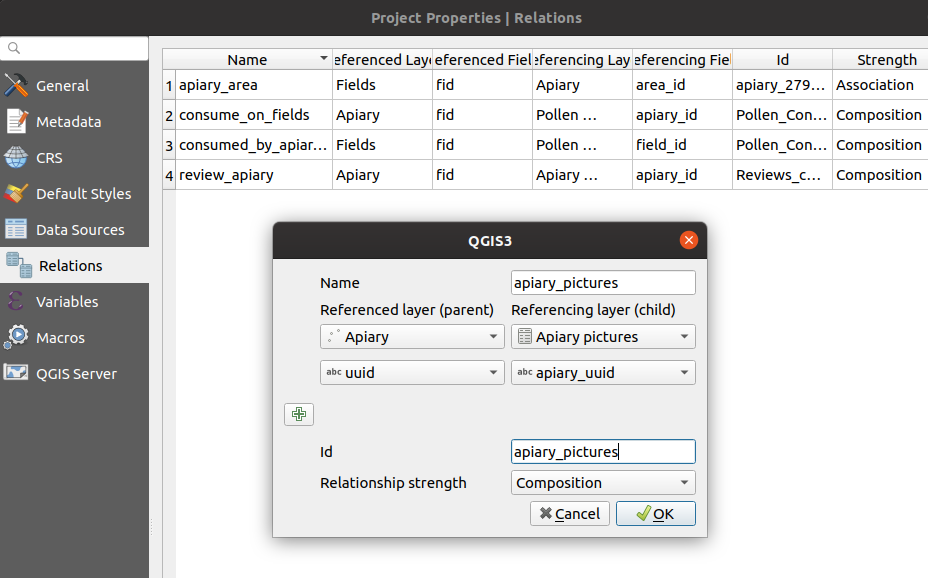

Relations
Create a relation with:
  • apiary Referenced layer
  • id Referenced field
  • apiary_picture Referencing layer
  • apiary_id Referencing field
  • strength Composition

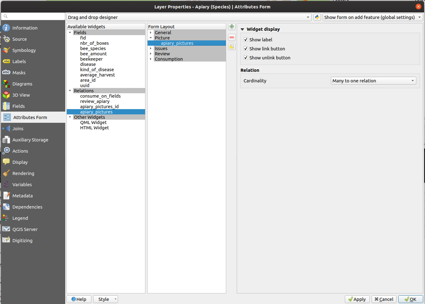

Set the relation widget to Many to one relation and add the relation to the form
widgets2

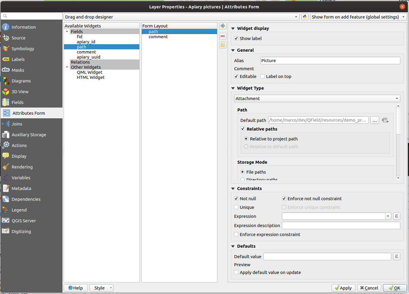

Set the widget type of the field path to attachment and add it to the form
widget picture
