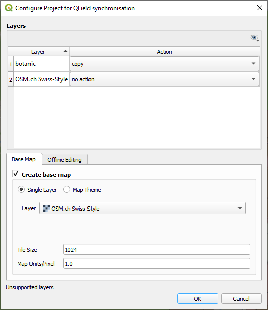

In QGIS with the plugin QFieldSync, set the base map to the «Project Configuration»
sync_basemap
Then make the package of the project to load it on your device.
sync_package1
sync_package2

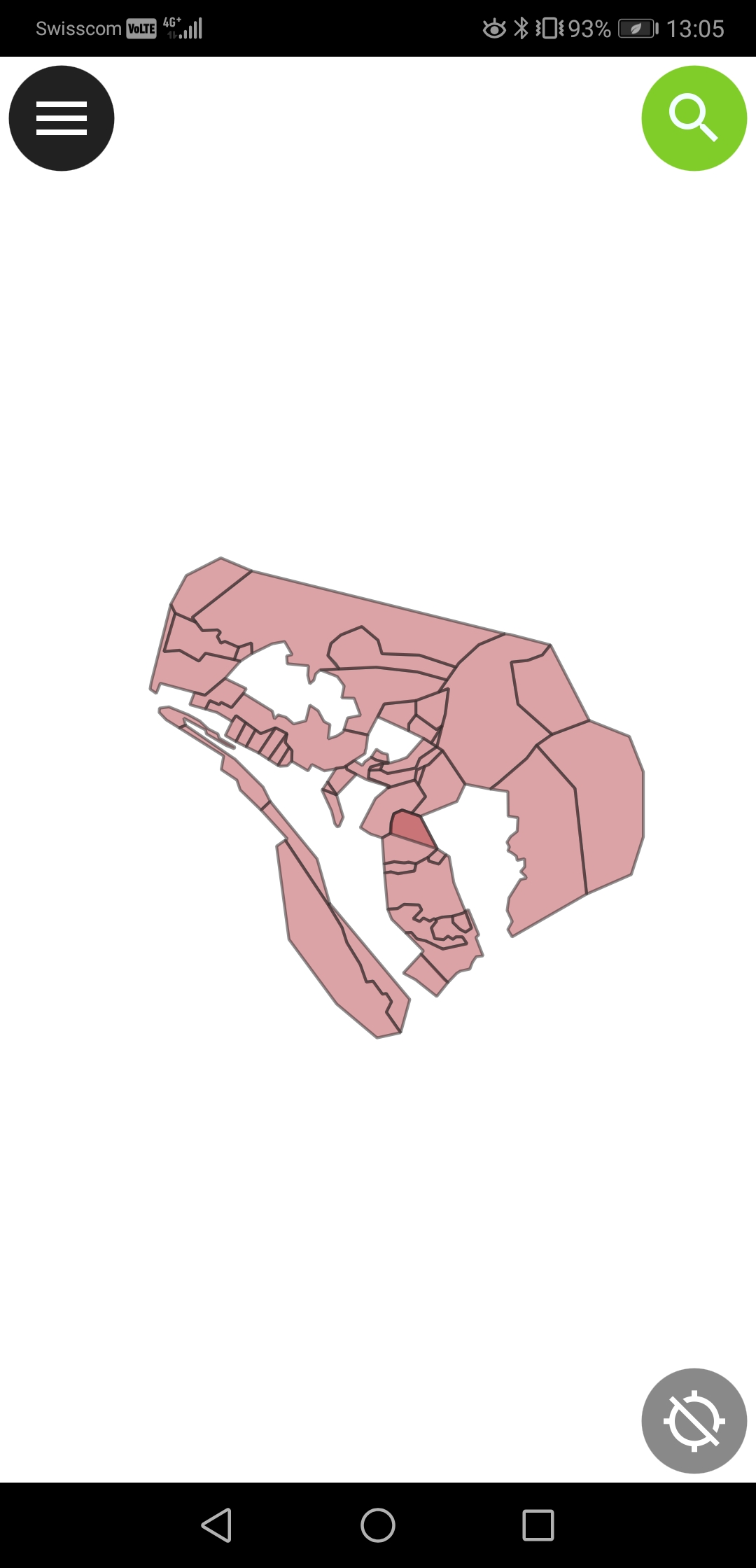

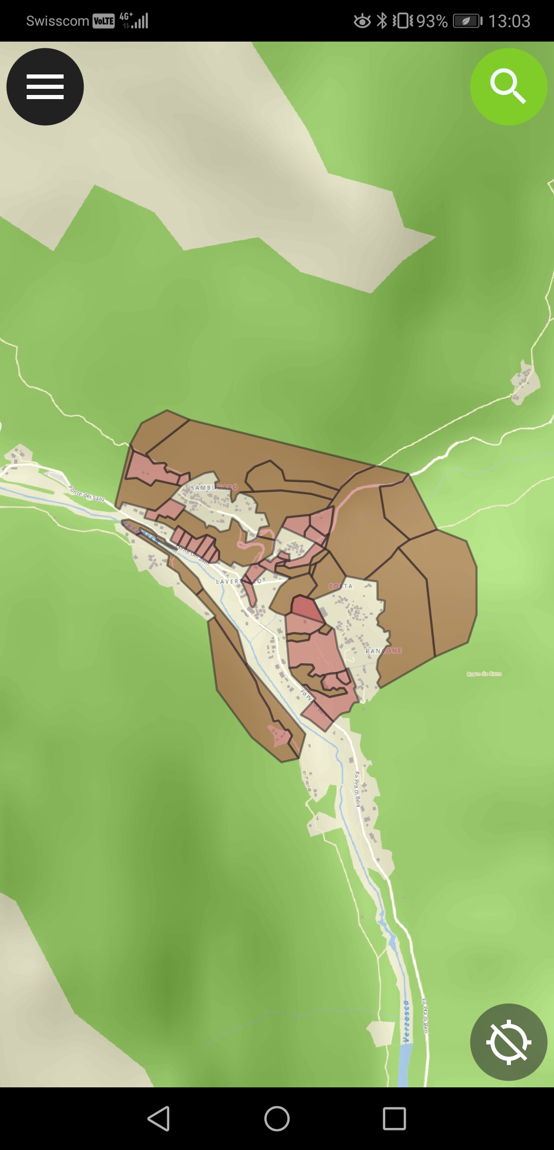

Below the result on QField.
