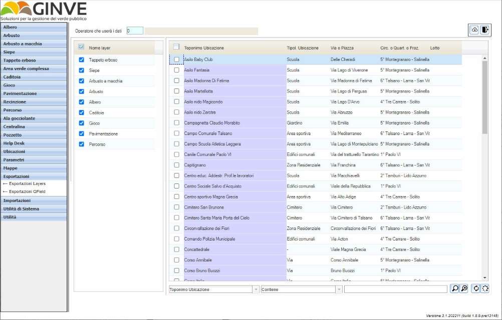

Initially, a procedure was set up in GINVE.CLOUD to generate a Geopackage and the corresponding QField project file from the GINVE.CLOUD platform.

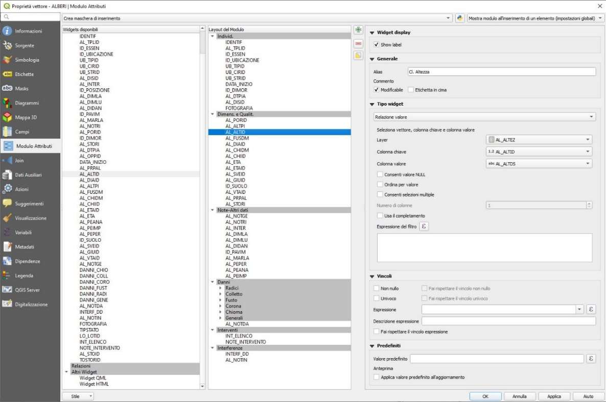

The Geopackage produced was structured to allow the management and mapping of data, supporting the insertion of point elements, lines, polygons and photos. In addition, form fields with customised attributes and value maps, value relations and check boxes were prepared in order to simplify data input by users.
In particular, the trees layer has been prepared to allow the management of forms for the collection of the following data: - Identification data - Dimensional and Qualitative - Notes-Other data - Damage - Interventions - Interference

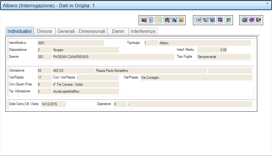

The data entry activity refers to the possibility of entering data relating to the position of the element on the map, the compilation of the element’s master data sheet, with photography and planning of interventions.
The graphic data were entered using both automatic positioning via GPS and manual positioning using the positioning functions offered by QField. The alphanumeric data were entered by filling in specific survey sheets with differentiated data according to the element selected.

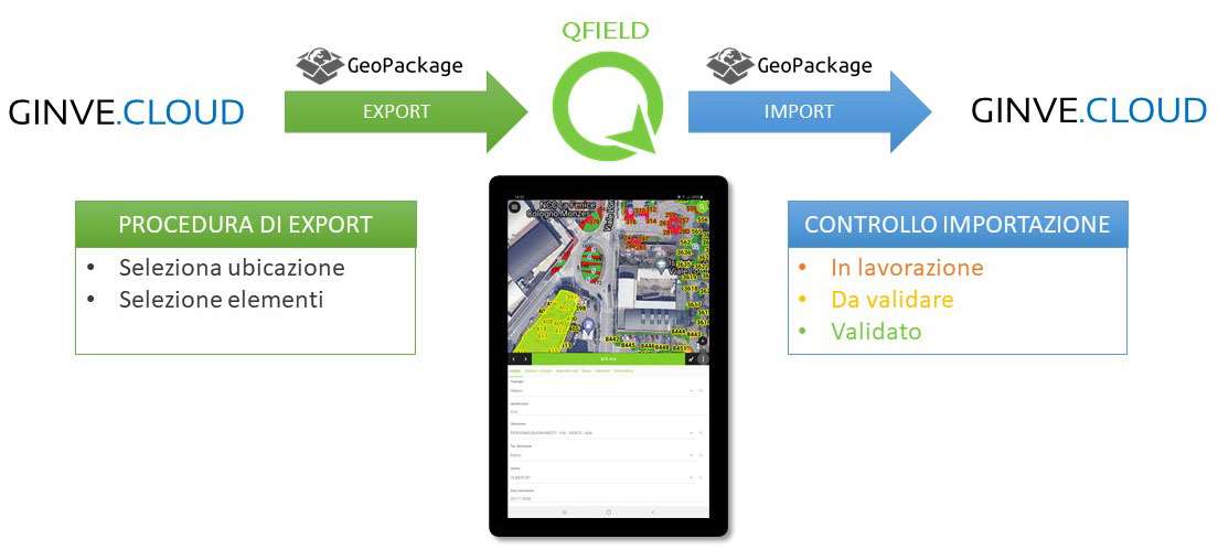

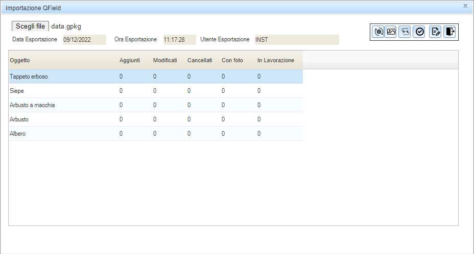

The collected data was then imported and synchronised with GINVE.CLOUD through a specific procedure that allows the verification of data (even from multiple operators) and alerts the user of any problems encountered, providing details of the error in order to facilitate its correction by the operator. This procedure also allows the import of photos that have been taken byQField and their automatic storage in the Cloud.
