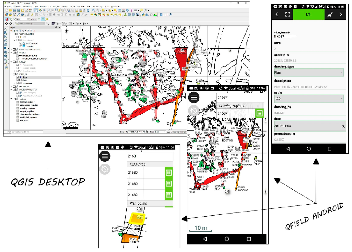

QField can be considered a “mobile” extension for QGIS. In fact, it allows us to view and manage a GIS project created with QGIS on an Android smartphone or tablet. Permitting the user to keep all set themes, labels and styles that are in the original project (Figure 1).

Figure 1 - An example of the same Survey GIS platform project in QGIS (below) and in QField (above). Image by Giuseppe Guarino 2019.

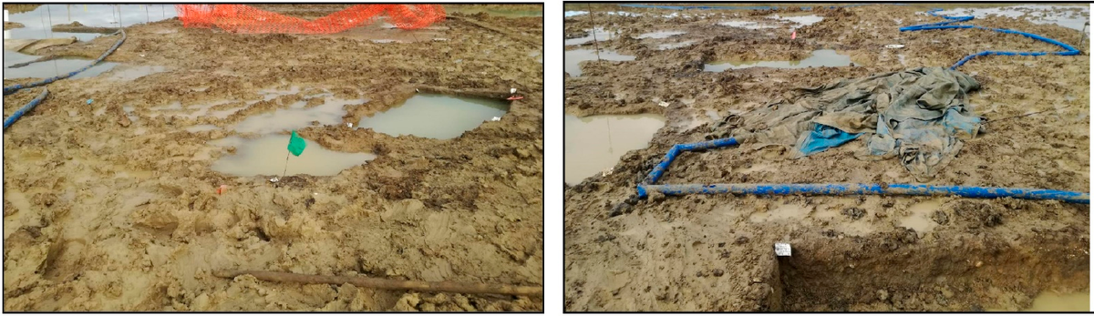

Figure 2 - An example of when the weather and visibility conditions in the field are poor. Image by Roberto Montagnetti 2019.

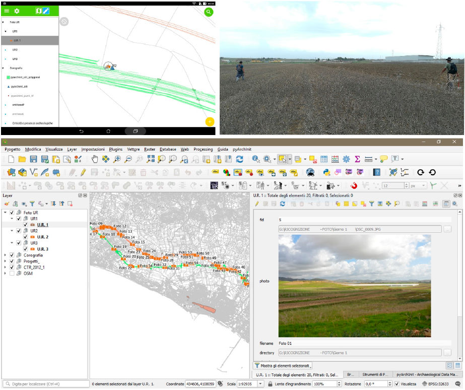

Figure 3 - An example of the same open area excavation GIS platform project in QGIS (above) and in QField (below). Image by Roberto Montagnetti 2019.
In fact, primarily, by using this system, archaeologists who are working in the field will be able to directly register the context numbers identified during the excavation within QField, in the appropriate “context register” table in the QField database.

QField aids with various challenges encountered in the field: time wasted due to inclement, wet weather and perpetually sodden and muddy soil churned up by people and vehicles continually accessing the site. These cause the identified archaeological features to become unrecognisable after several days of the site being stripped (Figure 2).
By using the device’s GPS, as it allows the user to navigate within the excavation area and to find, albeit with a certain margin of error, the archaeological features that need to be excavated, even when the visibility on site is poor.
Similarly, by doing so, when visibility conditions are bad, it is easier to centre with the slots in the archaeological features that have previously been identified in the Pre-Ex phase, which prevents the miscalculation of digging into the natural sites.
A typical example of this is when there are furrows running across the field, and it becomes increasingly difficult to see their entire length with the naked eye. Typically, in order to remedy this type of problem, archaeologists use printed maps in the excavation area.
