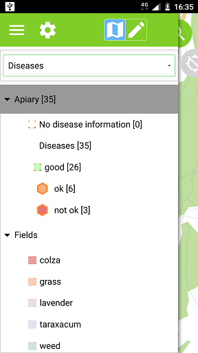

Karten Legende
Open the Main menu and expend the layers list to display the legend of the map.
user-guide_legend
