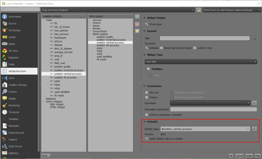

Variables adicionales
  • @position_source_name - The name of the device that gave location information as reported by the sensor. To differenciate between internal and external sensor. If the position is manually set, and the position is not snapped to the cursor, the source name is «manual». In case the cursor is not snapped to the position, all other variables will be null, if you need this, use the ``gnss_`` variables instead.
  • @position_quality_description - A human readable and translated string for the quality as reported by the sensor. E.g. «Fixed RTK». It is only available when the crosshair is snapped to the sensor. - E - IE
  • @position_coordinate - Un punto con coordenadas en WGS84. Longitud, latitud y altitud, tal como las proporciona el sensor. Solo está disponible cuando la cruz de posición está fijada al sensor. - x(@position_coordinate) - IE
  • @position_timestamp - La marca de tiempo en UTC tal como la proporciona el sensor. Solo está disponible cuando la cruz de posición está fijada al sensor - IE
  • @position_fix_status_description - The GPS Fix Status «NoData», «NoFix», «Fix2D» or «Fix3D» as reported by the sensor. It is only available when the crosshair is snapped to the sensor. - E
  • @position_fix_mode - Fix mode (where “M” = Manual, forced to operate in 2D or 3D or “A” = Automatic, 3D/2D) as reported by the sensor. It is only available when the crosshair is snapped to the sensor. - E
Ejemplos:
I: fuente de posición interna E: fuente de posición externa (NMEA)

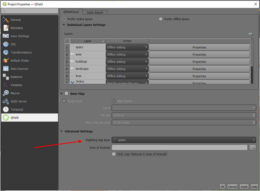

Vertex log
Then the user assigns the role «digitizing logger» on a point layer.
set up vertex log
