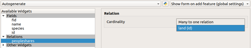

Relation Widget
The visual identification of the list entries are done via the „Display Expression“ of the child layer.
Key handling
Many-To-Many relations
