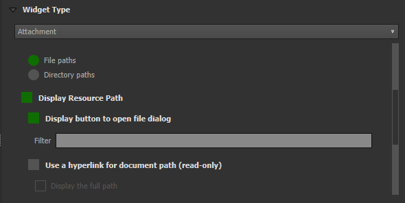

Attachment (photo settings)
The widget type ”Attachment” is used with fields that store the path to files.
It can be used to:
  • show and take photos
  • show links to external files like pdfs or documents
Attachement field settings
The path should be set to relative. The pictures, pdf and docs are stored then in a sub-directory of the project, where the link stored in the textfield is pointing to.
Kuva näytetään QFieldissä. Klikkaamalla kamerasymbolia käynnistetään kamera päivittämään kuvaa uudella kuvalla.
Picture in QField
On synchronization the sub-directory with the pictures, pdf and docs has to be copied as well.
The option ”hyperlink” on the attachment widget will disable the camera functionality and enable a hyperlink to open a document (pdf, doc, …).
hyperlink_option

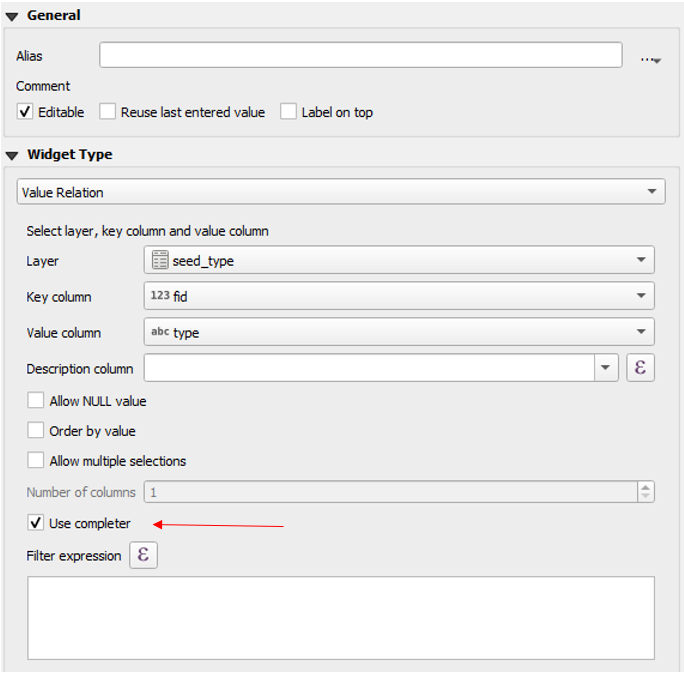

Auto-complete value
The “Use completer” checkbox must be checked to be able to use the auto-complete in the value relation.
../_images/autocomplet_form.png
Here a video showing how it works on QField Search in value list.
