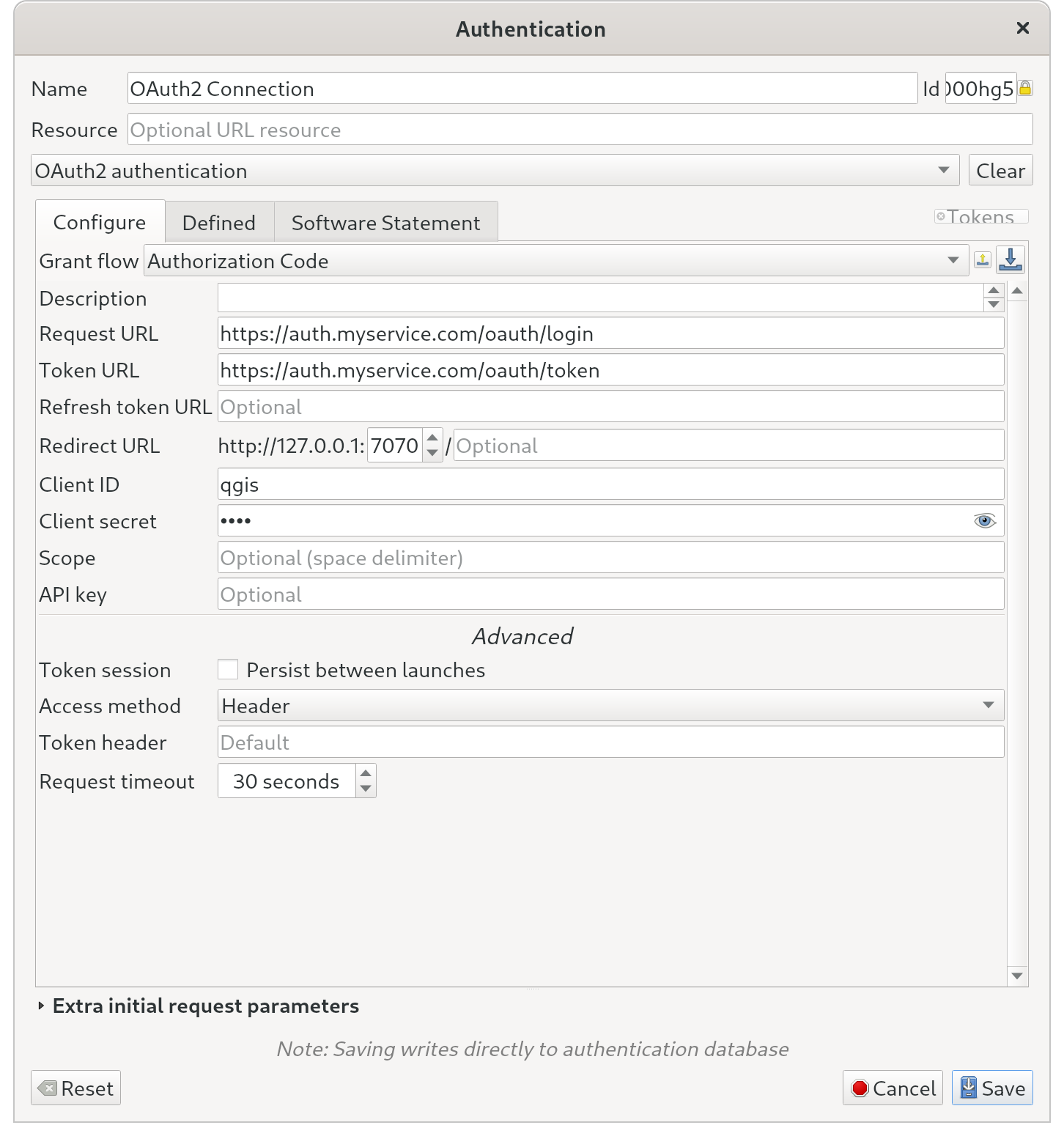

Engadir unha nova configuración de autenticación. Os parámetros precisan axustarse á configuración do servidor de oauth2:

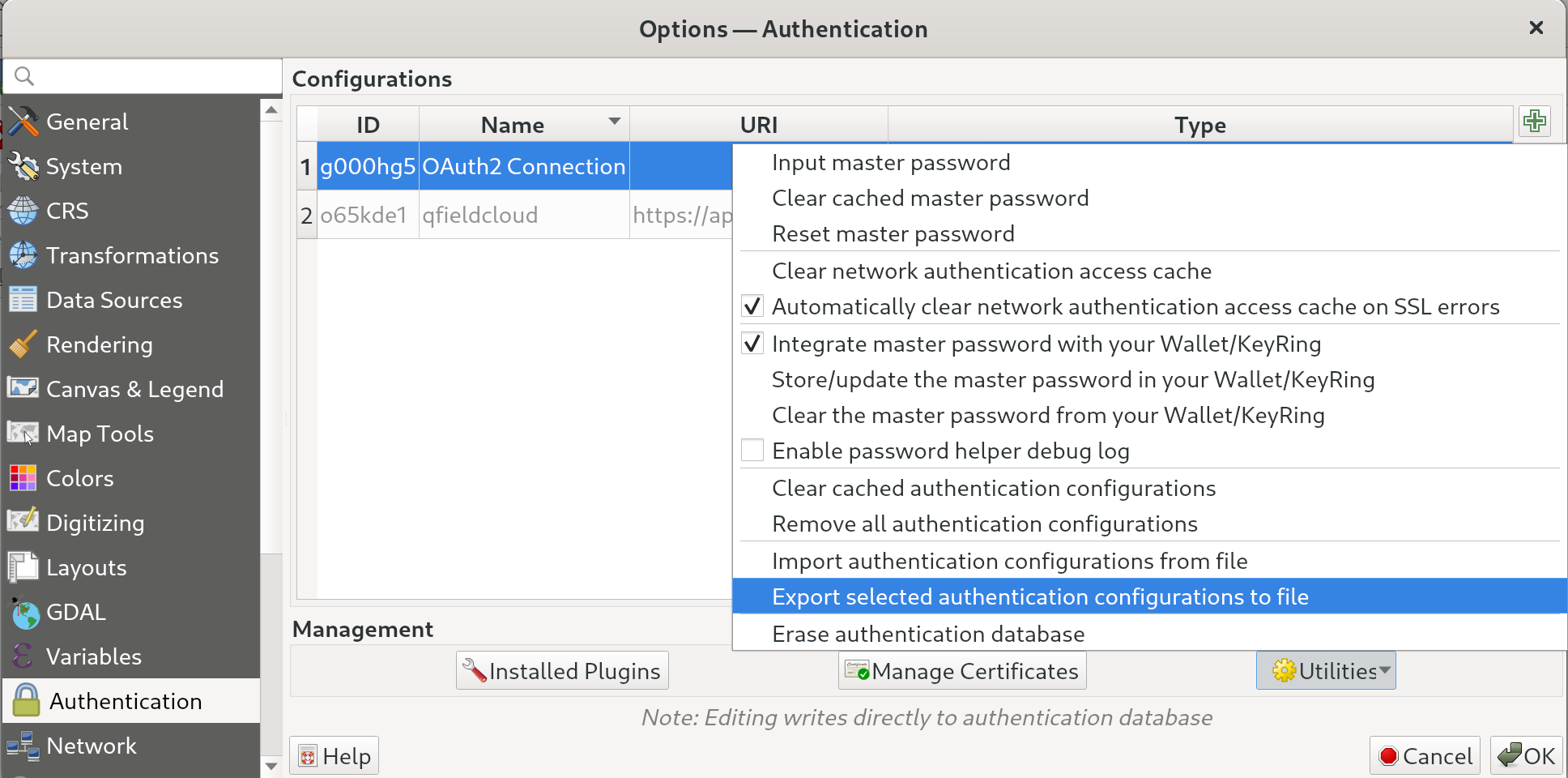

To do so, users open the QGIS options dialog and focus on the authentication panel. There, the user selects the OAuth2 configuration used by the project layer(s) by clicking on the appropriate row in the configurations table widget. Then, the user uses the lower-right utilities button to select the ‘export selected authentication configurations to file’ action.
