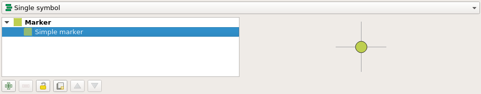

  2. Open the section Symbology in :menuselection: Properties –> Symbology.
  3. In the Symbol Layer Panel choose Simple marker.

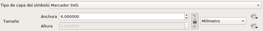

  1. Change the Symbol layer type in :menuselection: Symbol layer type –> SVG marker.
  1. Scroll down the bottom panel.
  2. Click on the right side of the file selection button to open the drop down menu.
  1. Select Embed File and choose the SVG file in the file selection dialog.
