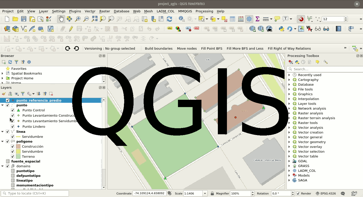

When you finish the installation of the plugin, you will see in the QGIS interface this buttons:
Once the installation process is finished, it is possible to start hiding the nodes of the legend our project.
  1. Choose the layers or groups that you want to hide.
  2. When you finish the layer/group selection, click Make selected layers and groups invisible. You will notice the selected layers and groups have disappear from the layers panel. They are still available in the project for visualization and joins, though.
