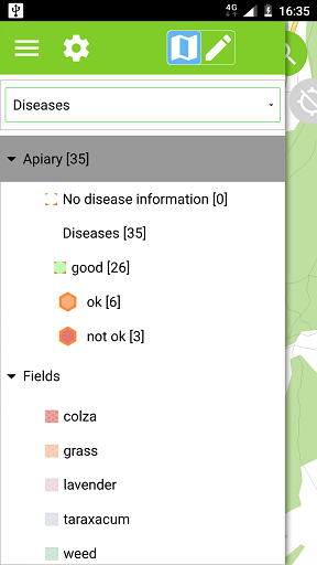

图例
打开**主菜单**,展开图层列表以显示地图图例。
user-guide_legend
Turning on and off layers
Main menu ‣ long press on the layer ‣ check or uncheck show on map canvas
turning_on_off

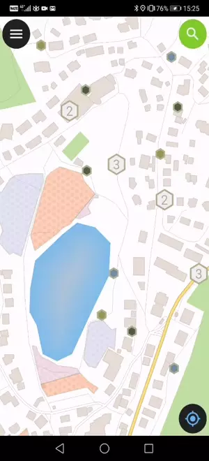

识别要素
Tap on a feature on the map to identify it. If several features are located where you tapped (either because there are multiple features really close one to another, or because several layers are overlapping), they will all be listed in the menu that opens on the right of the screen.
identify_features
点击列表中的某个要素以访问其属性。
  1. 点击**左右箭头**滚动显示识别出的所有要素。
  2. 点击**居中按钮**使得选中的要素在地图上居中显示。
  3. 点击**编辑按钮**可以编辑选中要素的属性。
  4. Scroll through the sub-menus to access all the attributes.
