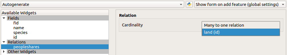

关系控件
The visual identification of the list entries are done via the "Display Expression" of the child layer.
Key handling
Many-To-Many relations

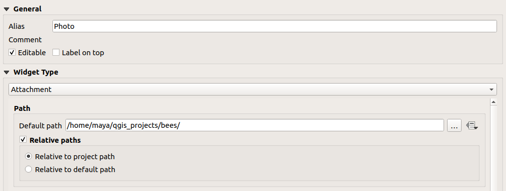

Attachment (photo settings)
The widget type "Attachment" is used with fields that store the path to files.
It can be used to:
  • show and take photos
Attachement field settings

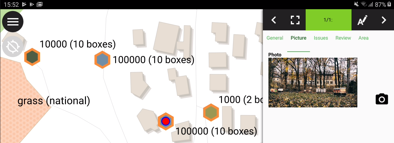

Picture in QField
The option "hyperlink" on the attachment widget will disable the camera functionality and enable a hyperlink to open a document (pdf, doc, ...).

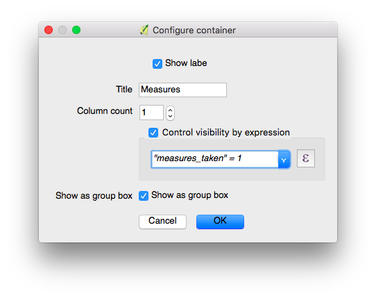

有条件显示
Groups can be hidden based on an expression. This is useful when certain attributes are only required under certain conditions. As an example imagine mapping trees. Some of them might have a disease and you have a list of possible deseases. To not clutter the form with many fields, make a group and configure a visibility expression for a group "diseases". Add a field "desease" with a checkbox. Only when the checkbox is checked, the list of diseases will be available to the user.
Configuration of a group box that will only be shown if the checkbox "measures_taken" is checked.

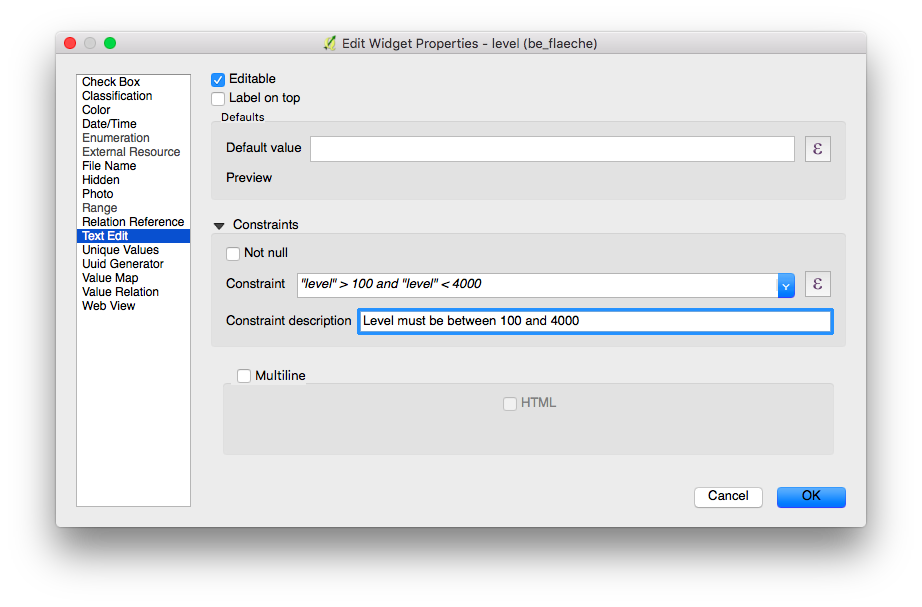

Constraints
Attribute fields can have constraints attached. Constraints are expressions that needs to evaluate to True (or 1) in order to be able to save the form. Constraints are configured on a per-field basis and a description can be added that will be shown to the user if a constraint is not satisfied.
Constraint configuration
Configuration of a constraint within a range

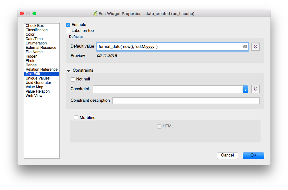

默认值
Fields can have default values configured. Default values are inserted into the attribute form when digitizing a new feature. They are visible to the user and can be modified as long as the field is editable. They can be based on the geometry or expression variables.
Default value configuration
