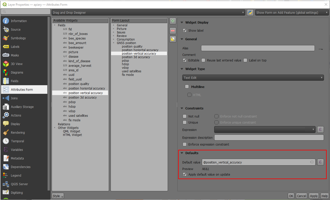

  • @position_source_name - The name of the device that gave location information as reported by the sensor. To differenciate between internal and external sensor. If the position is manually set, and the position is not snapped to the cursor, the source name is „manual”. In case the cursor is not snapped to the position, all other variables will be null, if you need this, use the ``gnss_`` variables instead.
  • @position_quality_description - A human readable and translated string for the quality as reported by the sensor. E.g. „Fixed RTK”. It is only available when the crosshair is snapped to the sensor. - E - IE
  • @position_fix_status_description - The GPS Fix Status „NoData”, „NoFix”, „Fix2D” or „Fix3D” as reported by the sensor. It is only available when the crosshair is snapped to the sensor. - E
  • @position_fix_mode - Fix mode (where «M» = Manual, forced to operate in 2D or 3D or «A» = Automatic, 3D/2D) as reported by the sensor. It is only available when the crosshair is snapped to the sensor. - E
Példák:
I: belső pozíció forrás E: külső (NMEA) pozíció forrás

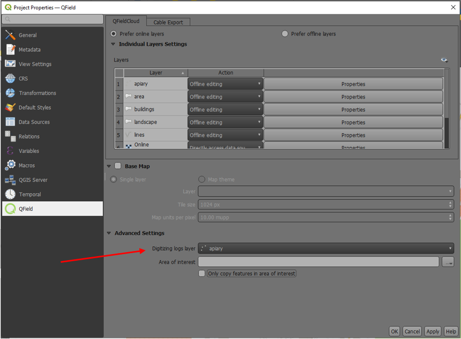

Vertex log
Then the user assigns the role „digitizing logger” on a point layer.
set up vertex log
