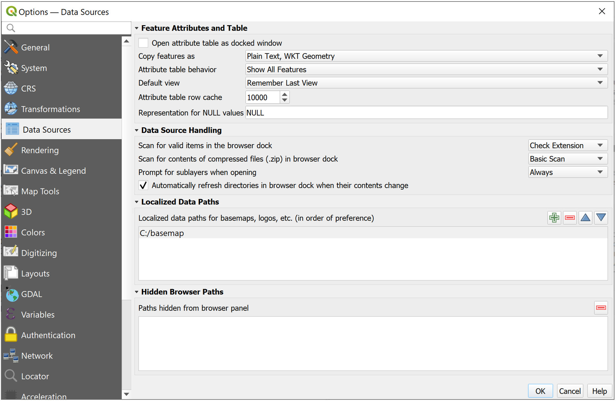

Desktop preparation
In QGIS, open Options > Data Sources > Localized Data Paths. In there, add the path to the external data.
To use layers from localized data paths on your device, add the datasets to the folder <drive>:/Android/data/ch.opengis.qfield/files/QField/basemaps
Since QField 2 the basemaps files needs to be stored in the app directory <drive>:/Android/data/ch.opengis.qfield/files/QField/basemaps
instead of the devices main directory <drive>:/QField/basemaps
